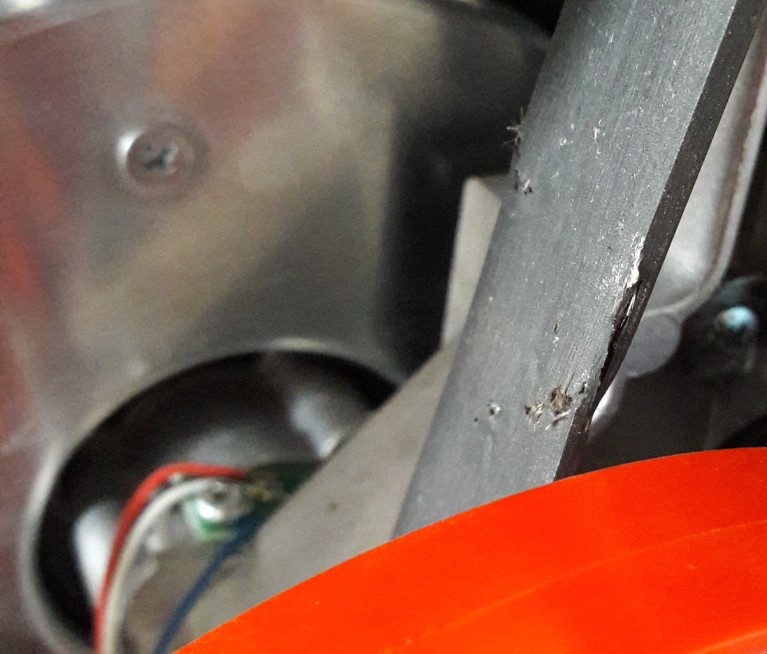

I just finished a long session of 1h30 on Zwift, at the end of the session the Direto made noises of "clack" several times and now it is hard all the time, the pedaling is not at all fluid it is jerky, and the direto no longer wants to manage the power, I even have a belt smell that heated
I took a photo through the air holes and it is easy to see that the belt is damaged

I bought the Direto the 12/04/18 I use it 4 times a week.

- belt direto.jpg (116.79 KiB) Viewed 39238 times

Alas the Direto is gone today!
But now I understand why the calibration drifted down every week and the popping noises.
The damaged belt loses its resistance to the rhythm of the sessions and the calibration was always on the decline.
The Assitance Elite, so offered me to adjust the belt, but adjust a belt already damaged aggravates the problem and is useless ...
We lost a lot of time in the diagnosis, it's a shame ...
At first the noises were sporadic, and were regular only on the last 2 Zwift sessions, until hard resistance and uneven pedaling.
I lost confidence with this material, because similar comments were already raised in October 2017, mine was bought in April 2018, more than 6 months after the problems persists.

I work in an industry where i maintain machines that use belt drives. To me this looks like an issue with the belt quality where the belt has been joined. Because of the nature of that type of belt with the numerous grooves if the belt is not joined in correct alignment this will cause the belt to track off at that point therefore being forced to jump back(the noise you hear)in to the grooves at that point on the belt. Which will cause premature failure of the belt.

@raphnou,
as I wrote before, in the first productions we had a problem with the guide pulley. This issue has affected less than 1% of the Direto.
This mechanical issue caused a shift of the belt and its break-up immeidately during the first training sessions.
This problem has been solved months ago.
In your case, as the trainer is not an old production and as you did a lot of sessions before the break-up, there must have been a defect in the belt itself (congratulation to Skyrunner39, you got it right!)

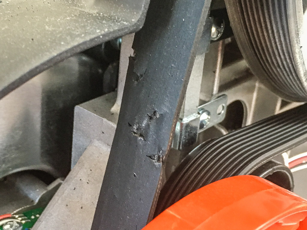

I just got the same on my Direto. I bought and started workout on zwift since April 2018. I did 5hrs per week workout with 160watt average power.
- Damaged belt
- Screenshot_20180618-185304~2.jpg (95.37 KiB) Viewed 38980 times

@peguz08@gmail.com,
there is clearly something wrong with the belt.

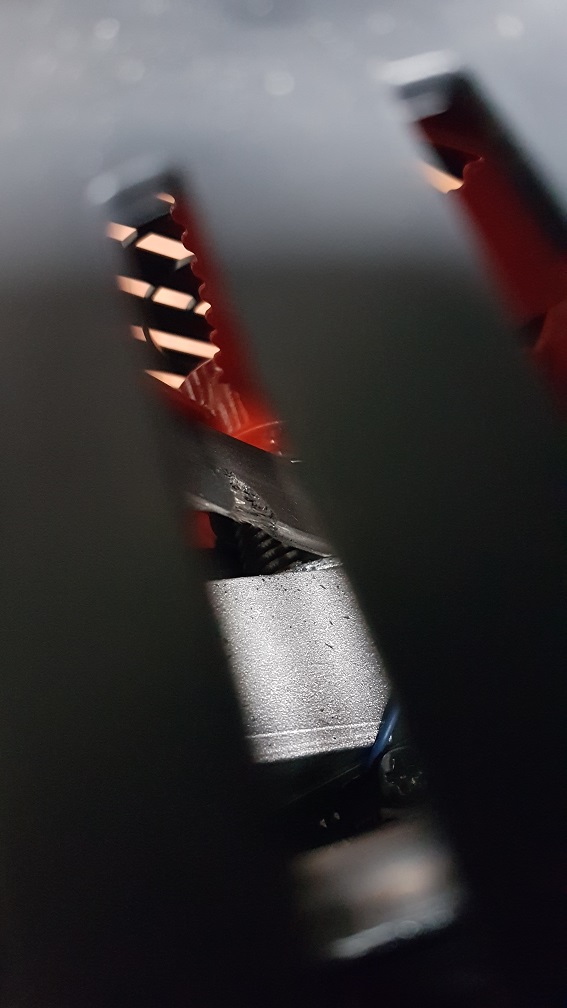

I bought my Direto in spring 2018 too and I did a workout almost every day since then. Now I have exactly the same issue.
I am in contact with the Elite customer care already - I have to thank you the guys for the quick support.
Just for information, here is a photo of my belt defect:
