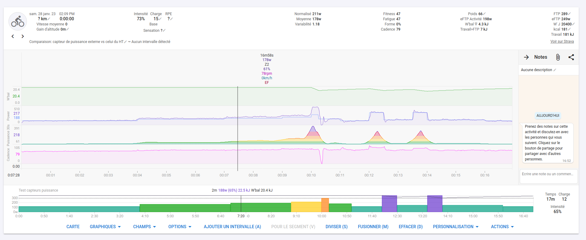

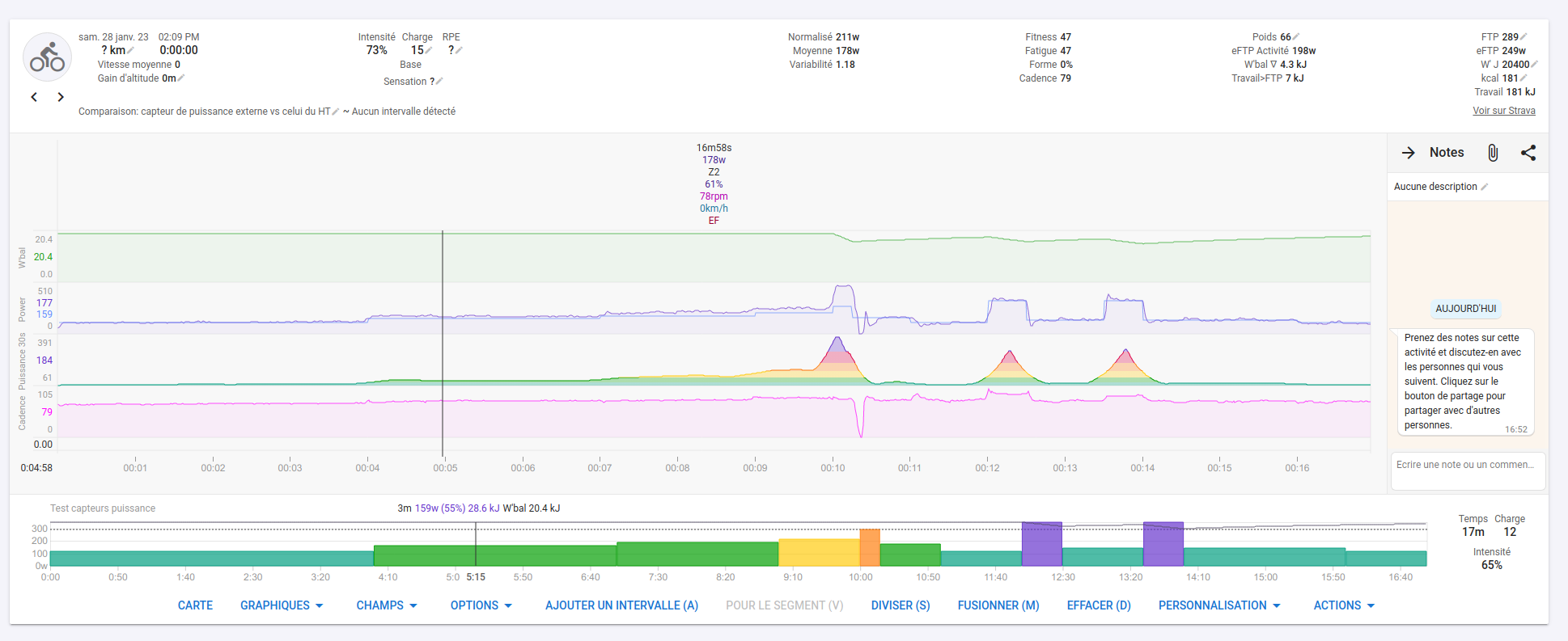

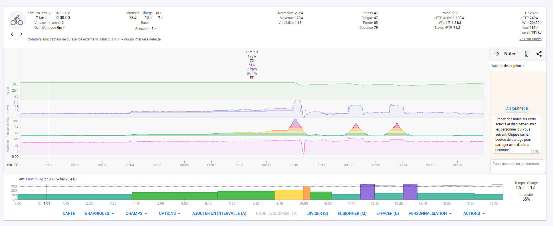

BB883 wrote:Update with a clear example :
Problems always occurs at the beginning of an activity (Zwift, Garmin, Elite App).
Stop pedaling seems to reset offset and sometimes solve the issue.
Defective motor / brake ? Impacted by low temperature ?
Same problem for me. I need to stop pedaling, somewhere between 4 and 10 minutes, then it returns to a normal behavior.
Here are some screen captures showing how it looks:
2023-01-28 17.17.22 intervals.icu 7107c2a784f4.png (122.27 KiB) Viewed 55257 times
2023-01-28 17.17.44 intervals.icu 38383a01fb4d.png (124.78 KiB) Viewed 55257 times

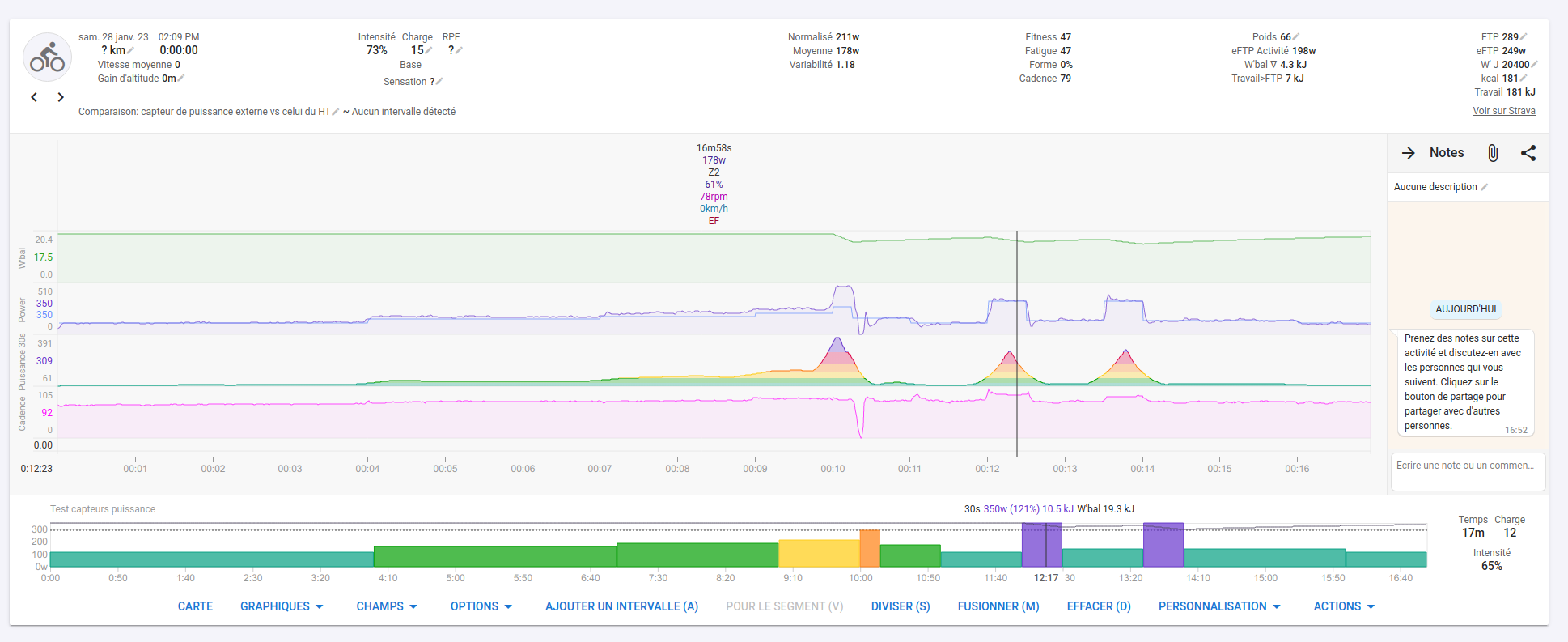

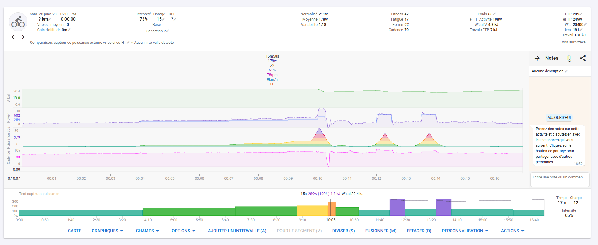

Postby jbroussia » Sun Feb 26, 2023 4:50 pm
2023-01-28 17.18.04 intervals.icu 2486d4df80ee.png (124.47 KiB) Viewed 55257 times
2023-01-28 17.18.12 intervals.icu d5a4e4894d98.png (124.86 KiB) Viewed 55257 times

On the "power" graph, the blue line is the target power that was supposed to be in ERG mode. As you can see, it slips upward after each interval during the first minutes, until I stop pedaling for a few seconds after the crazy interval (>500W with the DiretoXR when it was supposed to be 289W), then it finally reaches the target.
