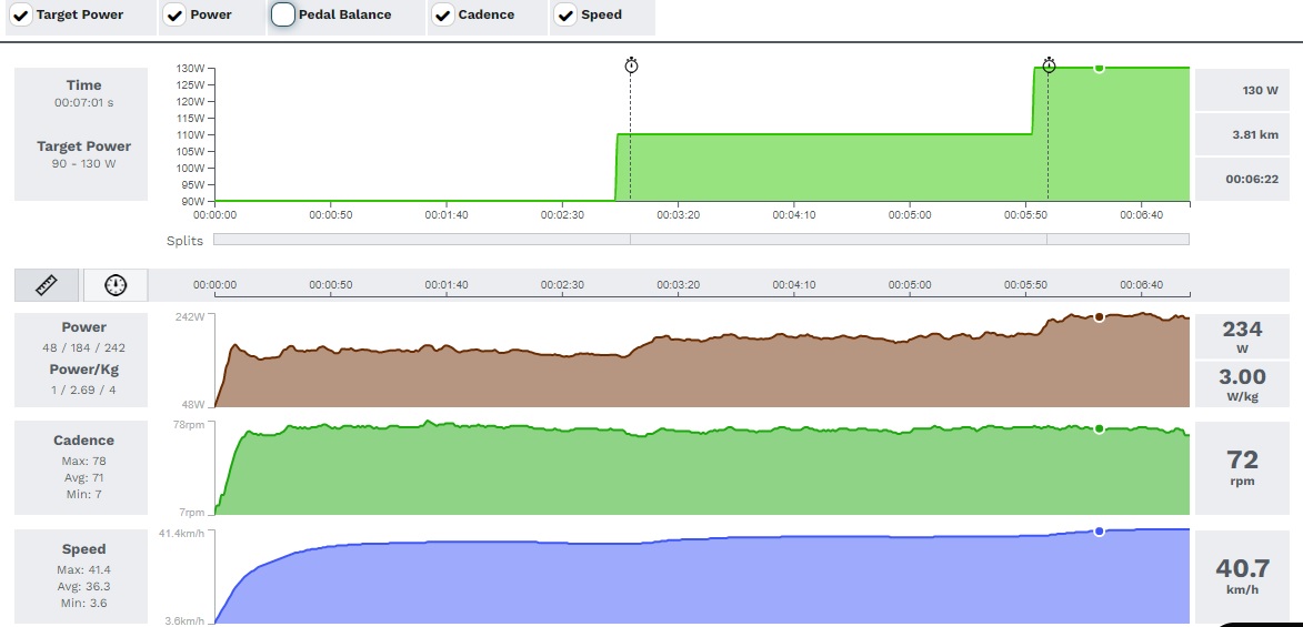

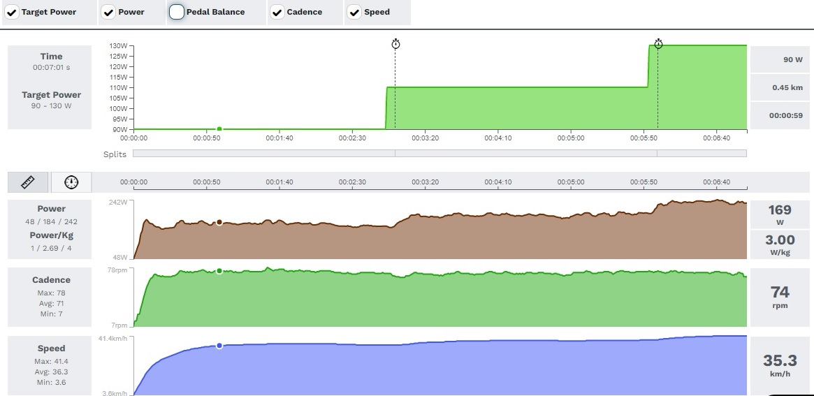

I made a short ride in rouvy . Almost flat route 12 km with 40 m of hill climb
I set up next values of power i need
1 - 90 wats for 3 minutes
2 - 110 watts for 3 minutes
3 - 130 watts for 3 minute
Result of that training u can see in attachments
1 interval trainer generates 160-165 watts
2 interval - 185-195 watts
3 interval 229-245 watts
Why u talking to me about speed in ERG mode? u want to say, that in ERG mode power depends from speed? Not speed from power??? Please tell me then, how i trained before? In ERG mode it doesn't matter how fast cadence is. And if trainer generates 150 watts, my speed will be 35-36 km/h, if 200 then 38.5-40 km/h. Speed in ERG mode is secondary parametr
at the same routes, i set up same protocols of training, and everything was fine, but last week my trainer make it's wrong. And seems like it's a software problem.
- 3 interval 110 watts.jpg (102.76 KiB) Viewed 14076 times
- 2 interval 110 watts.jpg (102.74 KiB) Viewed 14076 times
- 1 interval 90 watts.jpg (104.33 KiB) Viewed 14076 times
