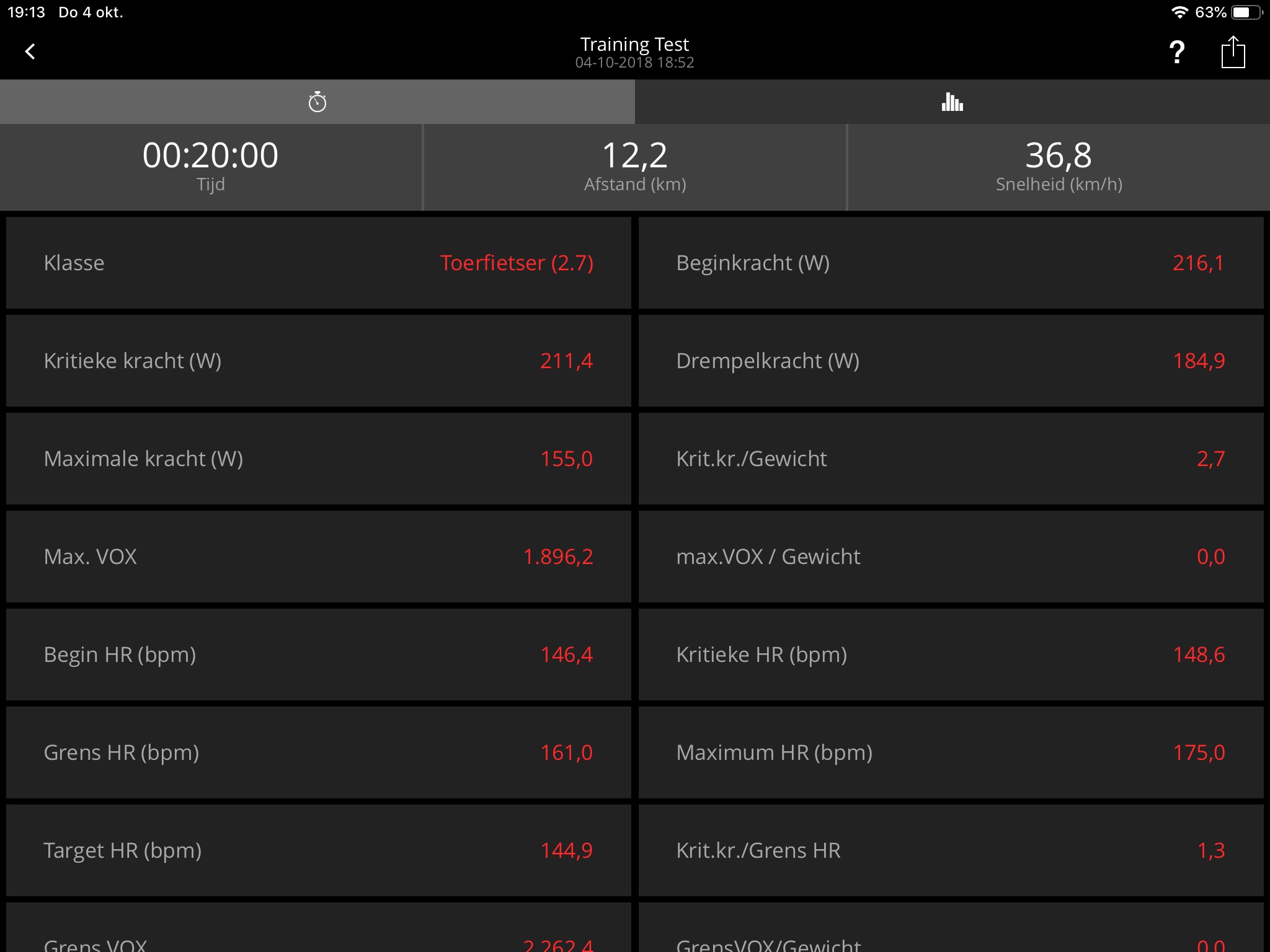

Please have a look at the attached Test results. When I start the training program the training goes into phase 1 . After 10 minutes it skips phase 2 and goes directly the phase 3, whichbis exactly thebsame as phase 3.
My questions:
Why does it skip phase 2?
What is the purpose of phase 3?
Is there a manual which describes how to read the test results?
My questions:

Re: My e training test
Sorry, probably I haven't explained myself very well.
PHASE 1
It's only a warm up.
PHASE 2
During this phasethe program will increase gradually the trainer resistance to raise your HR until it reaches the target value (which is the 83% of your max HR). When the HR value reaches the target value, the program will skip to Phase 3.
PHASE 3
Now you have to pedal for 10 minutes keeping your heart at the target level. In this phase, the program will continously adjust the trainer resistance to keep your HR as constant as possible (for example, if your HR raises too much, the resistance will be decreased to diminish the effort)
So, if at the end of phase 1 your HR value has already reached the target value, the program will skip directly to phase 3 and the result may be incorrect. This may happen if you are particulary out of shape or if your heart beats at higher values than usual (we are all different, so it may happen). In the first case, you have to train a bit more or maybe you have used wrong gear in phase 1. In the second case, you can modify your max HR in the rider setting but only after consult a doctor.
I hope that now it's all clear
PHASE 1
PHASE 2
PHASE 3
