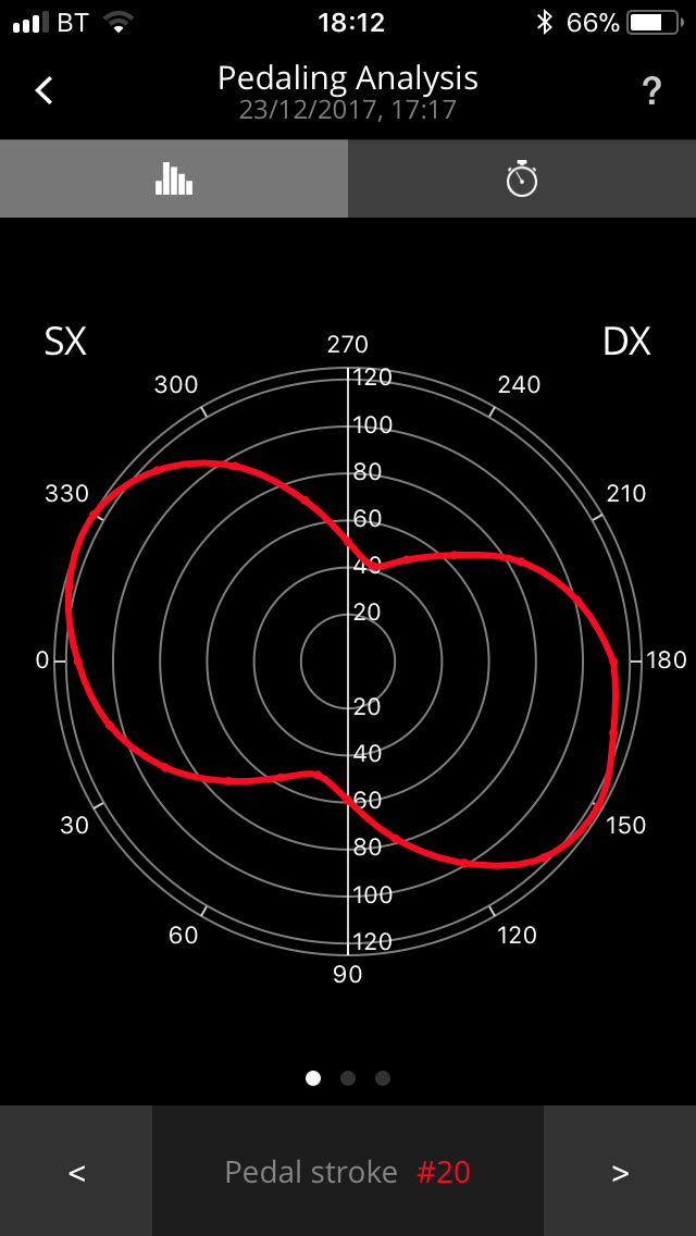

Have have connected the cadence sensor to my Drivo and run the pedal analysis tool.
The graph shows the wrong orientation with the left foot top showing at 90 degrees instead of 270 degrees.
I previously used a Wahoo cadence sensor on the pedal tool and it showed the correct orientation. This sensor is now switched off.
I have mounted the Elite wired sensor exactly as per instructions.
Graph of wrong orientation is here
Pedal pic.PNG (104.29 KiB) Viewed 6424 times

Postby Elite Admin S » Thu Jan 25, 2018 10:49 am
You have to go into the settings and put the correct offset.
Please take a look at this document at page 9:
http://drivo.cc/system/cms/document/dat ... sis_02.pdf
