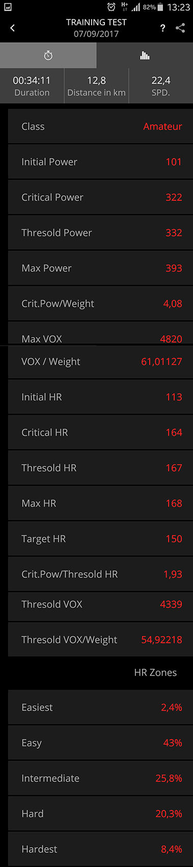

I don't exactly understand what should I do on phase 3. Especially the last 5 minutes. Do I have to crank whatever I have got. The arrows which blink up and down to slow or speed up don't appear in the last 5 minutes. So do I have to ramp up and drain whatever I have got or should I do something else. I read all the explanations but there is an information gap in Phase 3.
In the last test I had the conclusion of: Critical Power=322, Thresold Power=332
I don't think it should be that high. It should be something around 310-315 watts.

- training-test-myetraining.jpg (143 KiB) Viewed 31284 times

In the last phase you have to keep your heart rate costant (the app will adjust the resistance to help you keeping it at the target value). That's the only important thing in this part of the test.
The values you've reported seems to be very similar to what you expected (10w of difference is not much). Can you explain me why you think they are wrong?

Yes, I did as you explained. In the beginning of phase 3 the software ramps up very high and makes yo tire quickly and then it begins to decrease the power so much that the pedals begin to spin very easily and my heart rate drops very quickly below my target hearth rate (which is 150). So I have to change gears and make it harder for myself. I mean I have to control it on my own. The software recognises the situation later than me.
As a conclusion I'm trying to stay in my target heart rate zone in the last five minutes as accurate as I can (which is 150 +-3).
What if I stay in the zone of 160-165?
Does it effect the result? Will it read my FTP lower or greater? I think it will read it greater...
