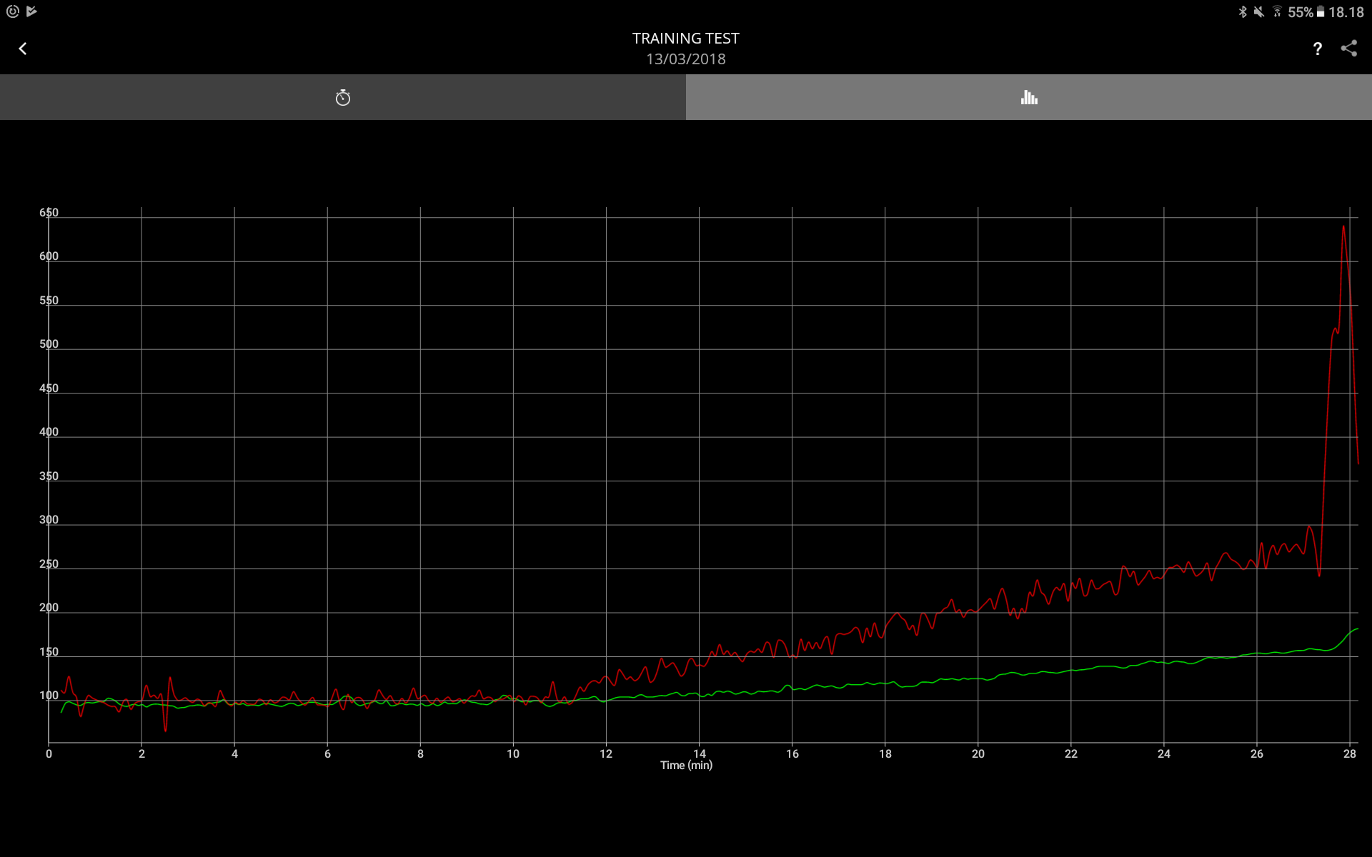

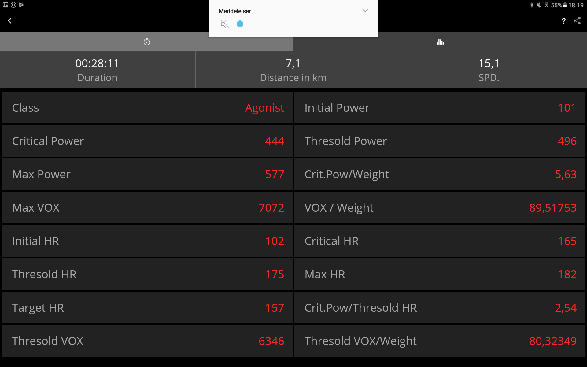

Just did a test today... And could not be further from what was suppose to happen in test phase 3.
The resistance just kept going up, till I had to stop the test.
Is there a solution to do a proper test in the app?
Even though I would love to have a threshold power like the test showed, I doubt I am in that kind of shape.

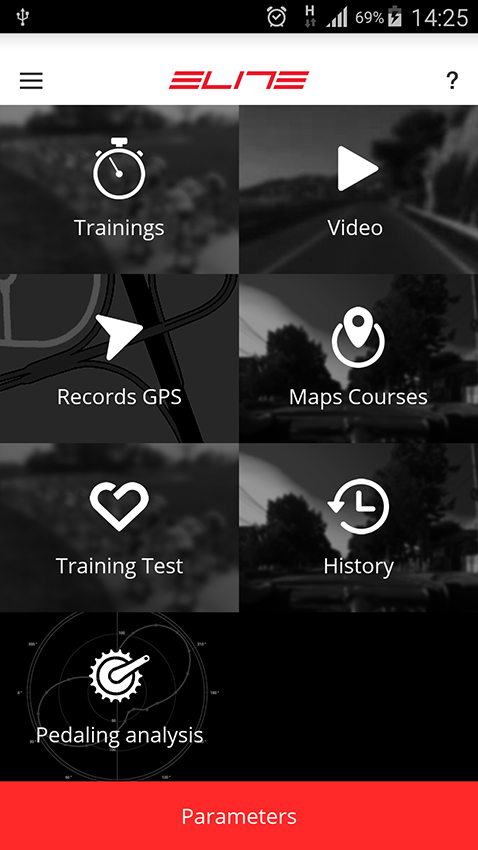

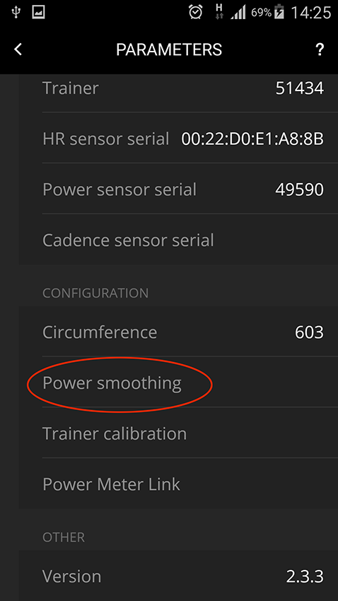

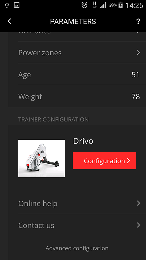

Re: EliteMyTraining Training Test Phase 3
Sorry for the delayed answer.
To solve this problem follow these steps:
1. Open the My-E-Training app.
2. Press the "Parameters" red button.
3. Enter the "Advanced Configuration"
4. Enter the value "10" in to the "Power smoothing".
After this procedure your problem will be solved.
Important: Try to maintain a very smooth constant cadence in the test till it finishes.
