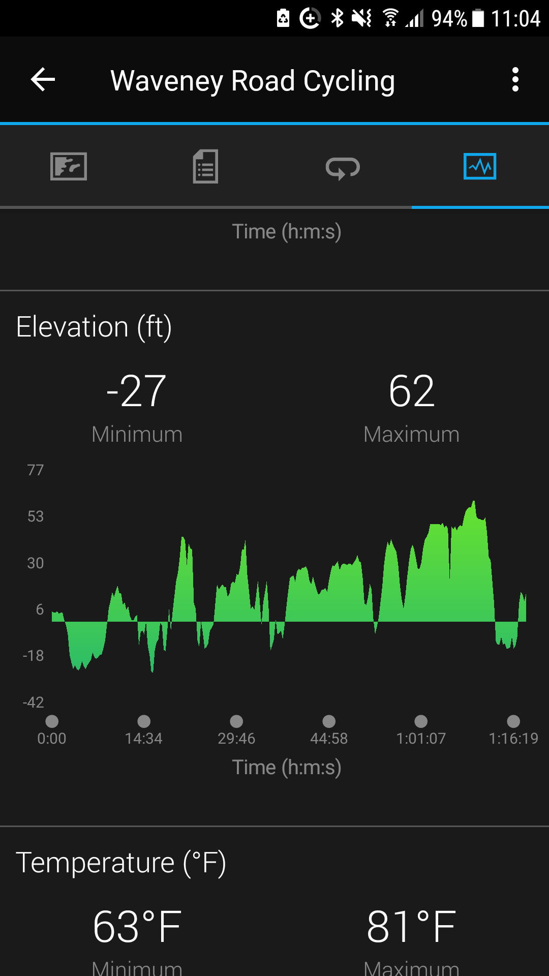

What is the best way to convert the file? I got it directly from my garmin edge 1000 and then converted it to kml. Customer services say the gps file has been recorded incorrectly could it be the conversion process? The attached screen shot is the file I used.
Thanks

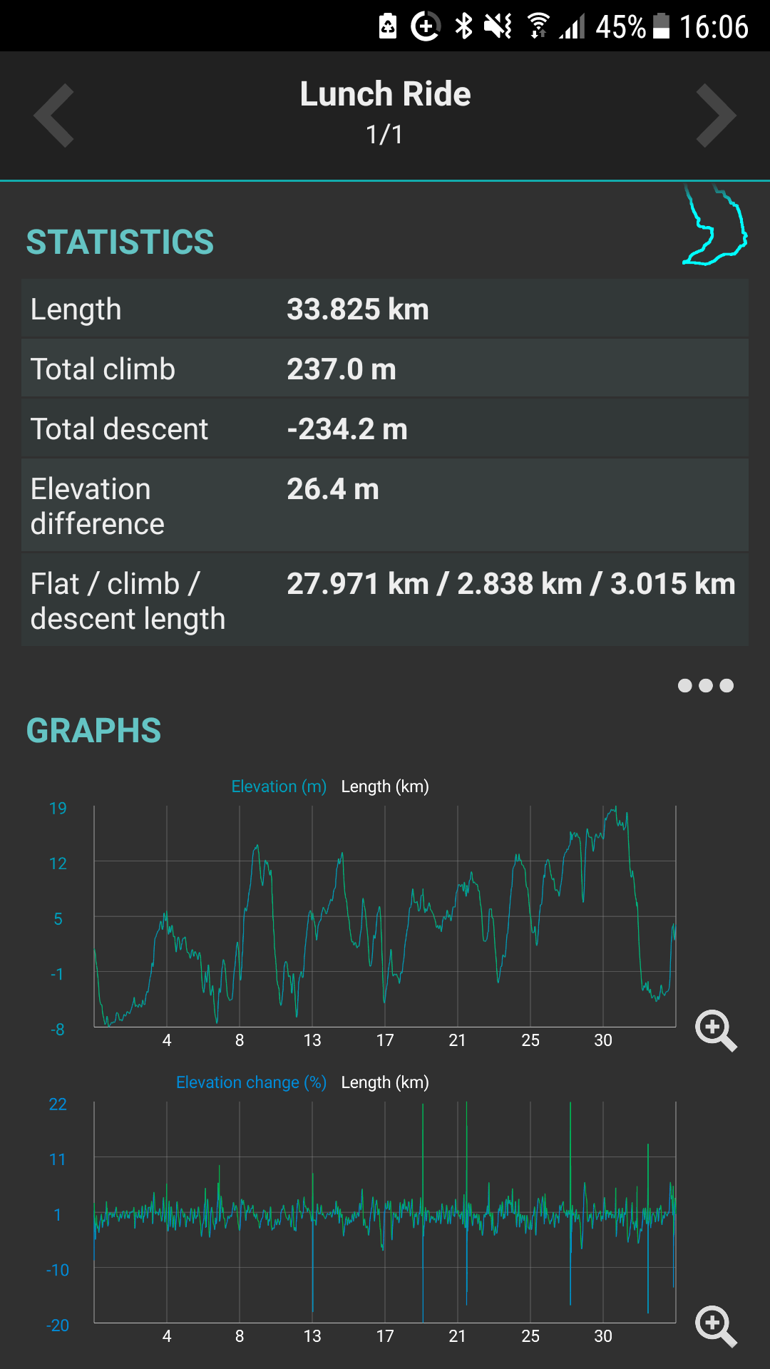

I have attached another interpretation of the fore mentioned file. Elite admin could you tell me which graph would the elite software follow when using the course on the elite software?
The "Tracks_lunch Ride" is the gpx un converted version
"Lunch Ride" Is the concerted kml file.
To me they look identical.
Which graph does the software follow?
- Gpx
- Screenshot_20180519-161700.png (191.43 KiB) Viewed 30798 times
- Kml
- Screenshot_20180519-160609.png (191.47 KiB) Viewed 30798 times
Re: Riding uploaded kml. Route
Hi guys
First of all... please, when you attach images, remember to reduce the dimensions. The discussion will be more "readable".
About the kml files, it's a bit complicated.
We noticed that often the kml files includes some anomalies that can cause some problems.
I don't know if this is your case, though. The only way to understand the situation is to analyze the kml file.
So, please contact the customer care at myetraining@elite-it.com adding the file and explaining the situation.
