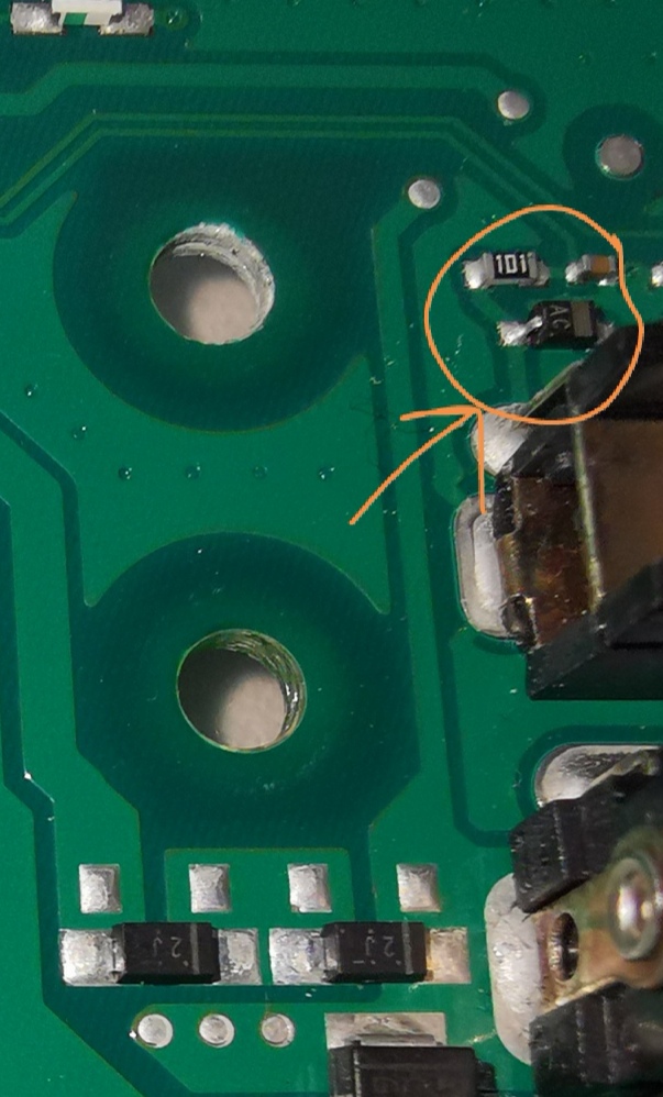

I found a component closed to the cadence jack, labeled 'AC' to be shorted upon measuring with multimeter, I guess it is a SMD diode, please confirmed that? Or can you send me a copy of the PCB schematics so that I can continue to troubleshoot
AC

I removed the AC and that's not the root cause, I need to reorder the board.
