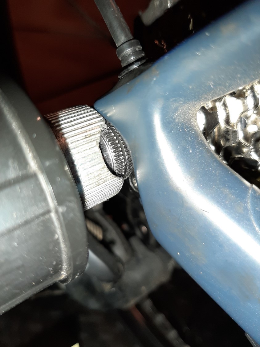

the photo will immediately explain the situation. I´m trying to use a hometrainer Force with a BMC SLR02. But you can immediately see that the frame of the bike is so tight to the quick release that there is no chance to close the fixing lever. If I press the lever, then the metallic extremity would press its force on the frame with risk of damaging it. Did anyone encountered this problem? Do you have any suggestion on how to fix this issue? Thanks
bike does not fit
Re: Bike Won't Fit??
Postby Elite Admin S » Tue Oct 06, 2020 11:17 am
Please use the quick release included with the trainer.
Also, use a spacer/washer on the other side and let me know if you're able to fix it

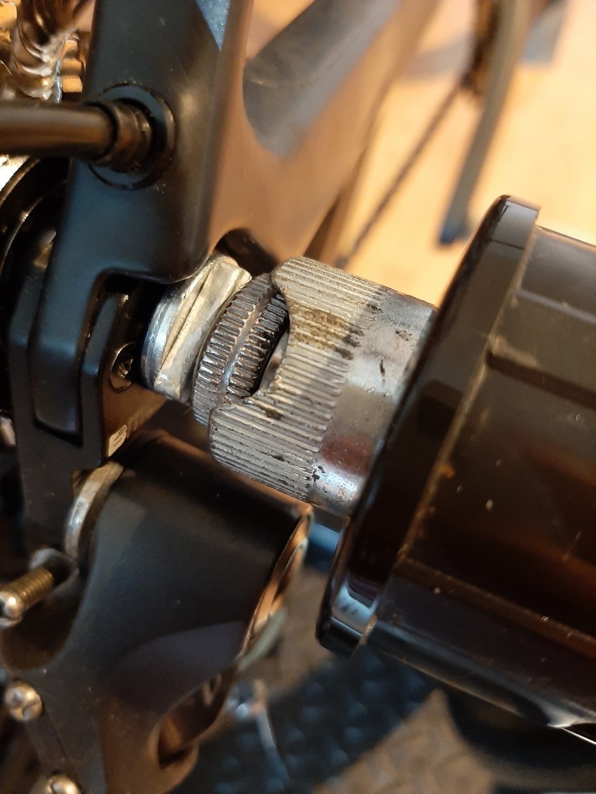

Hallo,
I have used a couple of washer and this is the final results. Now I´m wondering if this configuration is fine in terms of force load on the frame of the bike. The level closes, so it looks like it should be, but I´m not an expert, hence I´m just worried my bike. Any thoughts?
picture b.jpg (156 KiB) Viewed 13314 times
Postby Elite Admin S » Wed Oct 07, 2020 8:13 am
If all is well fixed there won't be any problem don't worry!
